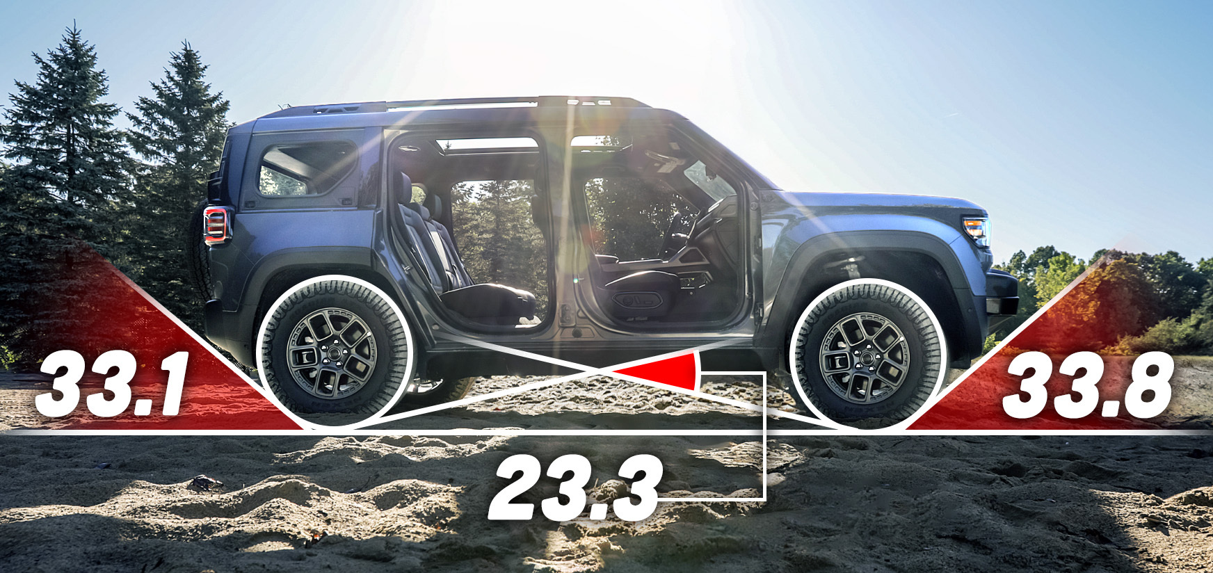

I start pretty much every off-road evaluation the same way: by reminding everyone that the single most important attribute a good off-road vehicle needs is favorable geometry. This means more than just ground clearance, it means short overhangs and small overall dimensions. It doesn’t matter how much fancy gadgetry a vehicle has onboard if it can’t get its front tires onto an obstacle because its long front bumper gets in the way.
As you can see in the image above, the Jeep Recon’s approach angle and departure angles are 33.8 degrees and 33.1 degrees, respectively. These are fantastic, and the 23.3 degree breakover angle isn’t bad, either.
For context, the Ford Bronco, Jeep Wrangler, Land Rover Defender 90, and Suzuki Jimny offer approach and departure angles in the 40-degree range, but nobody thought the new Recon would be among the top-dogs of the off-road world. Go down half a tier, though, and the Recon is right there, geometry wise, with the likes of the Mercedes G-Class, Toyota Land Cruiser, and Rivian R1S.

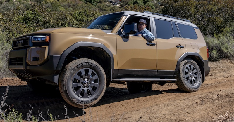

The Toyota Land Cruiser’s approach angle is 31 degrees, its departure angle is a downright weak 22 degrees, and the breakover angle is 25 degrees. The Recon may drag its belly a bit more than the Land Cruiser, but those extra two degrees of approach angle and the extra 11 degrees of departure angle will definitely outweigh the breakover angle deficiency.

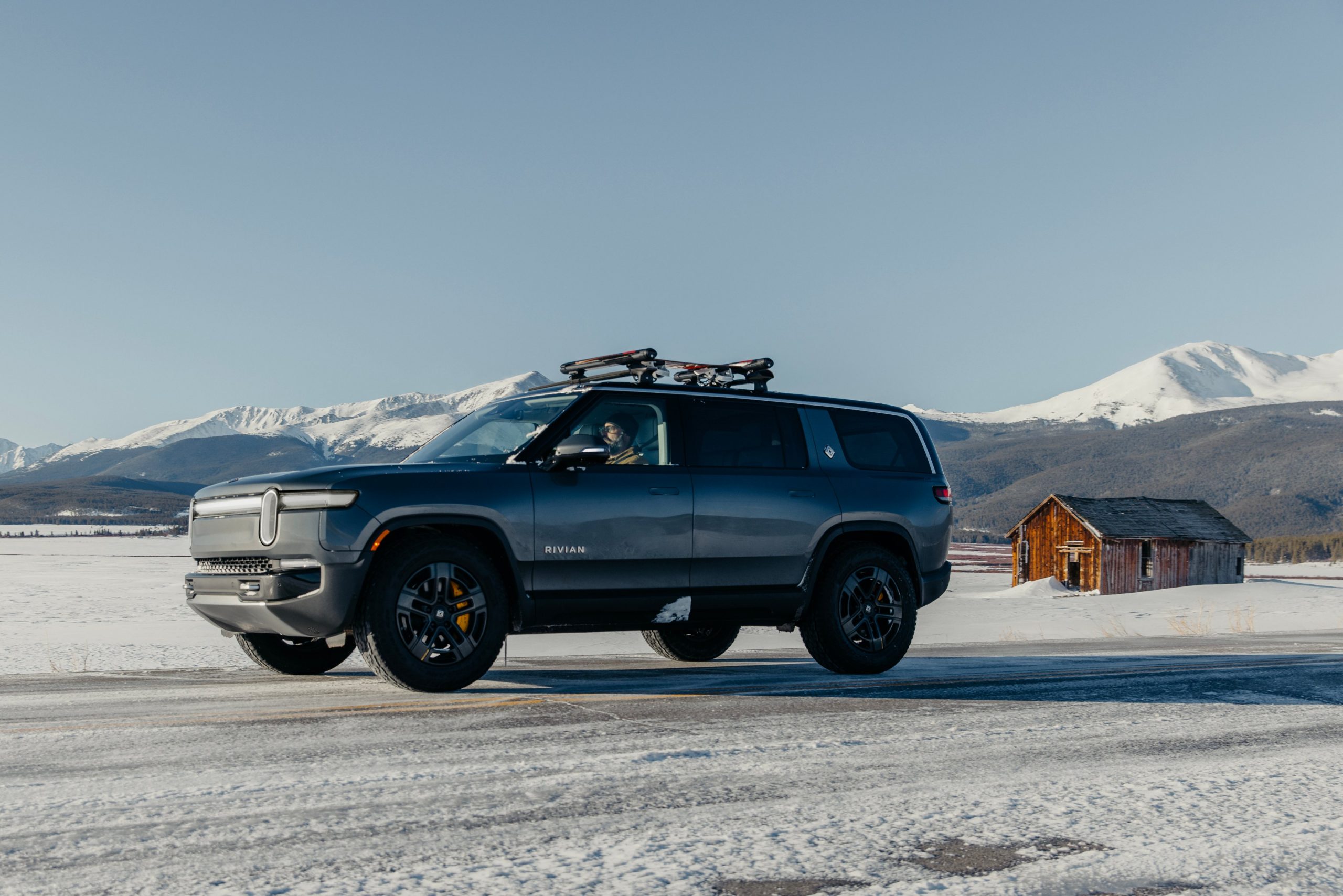

The Rivian R1S’s short front overhang gives it an approach angle of 35.8 degrees, the rear end yields a good 34.4 degree departure angle, and the breakover angle is a great 29.7 degrees. Rivian is leveraging air suspension to pull this off, jacking the car up to 14.9 inches of ground clearance. The Recon, by comparison, uses fixed-height coil springs, which offer a decent 9.1 inches of clearance.

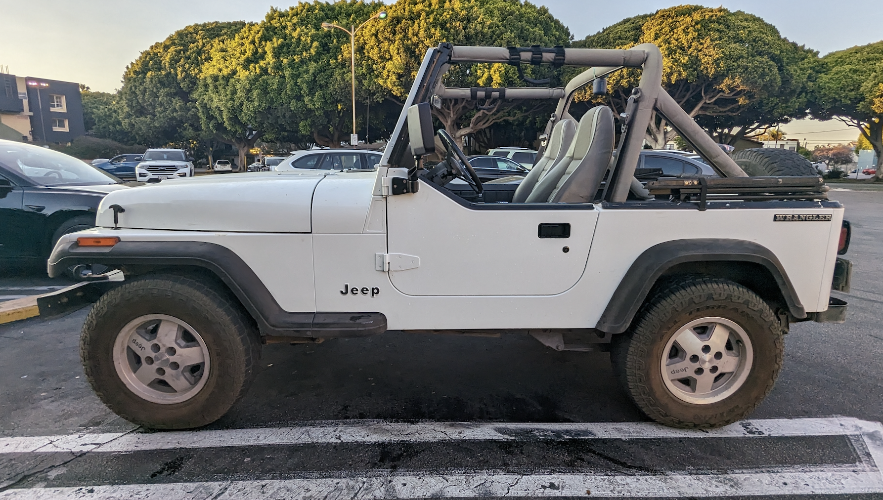

For example, my Jeep Wrangler YJ (above) has less than 9.1 inches of ground clearance at the differentials, but it just doesn’t matter, because the differentials are always pulled way up high by the tires, which are climbing the rocks that pose the biggest risk to the diffs. Notice how the rest of the body — the front and rear overhangs, and especially the rocker panels that are just aft of the front tires that will be coming down off rocks or logs or whatever — is way up high.

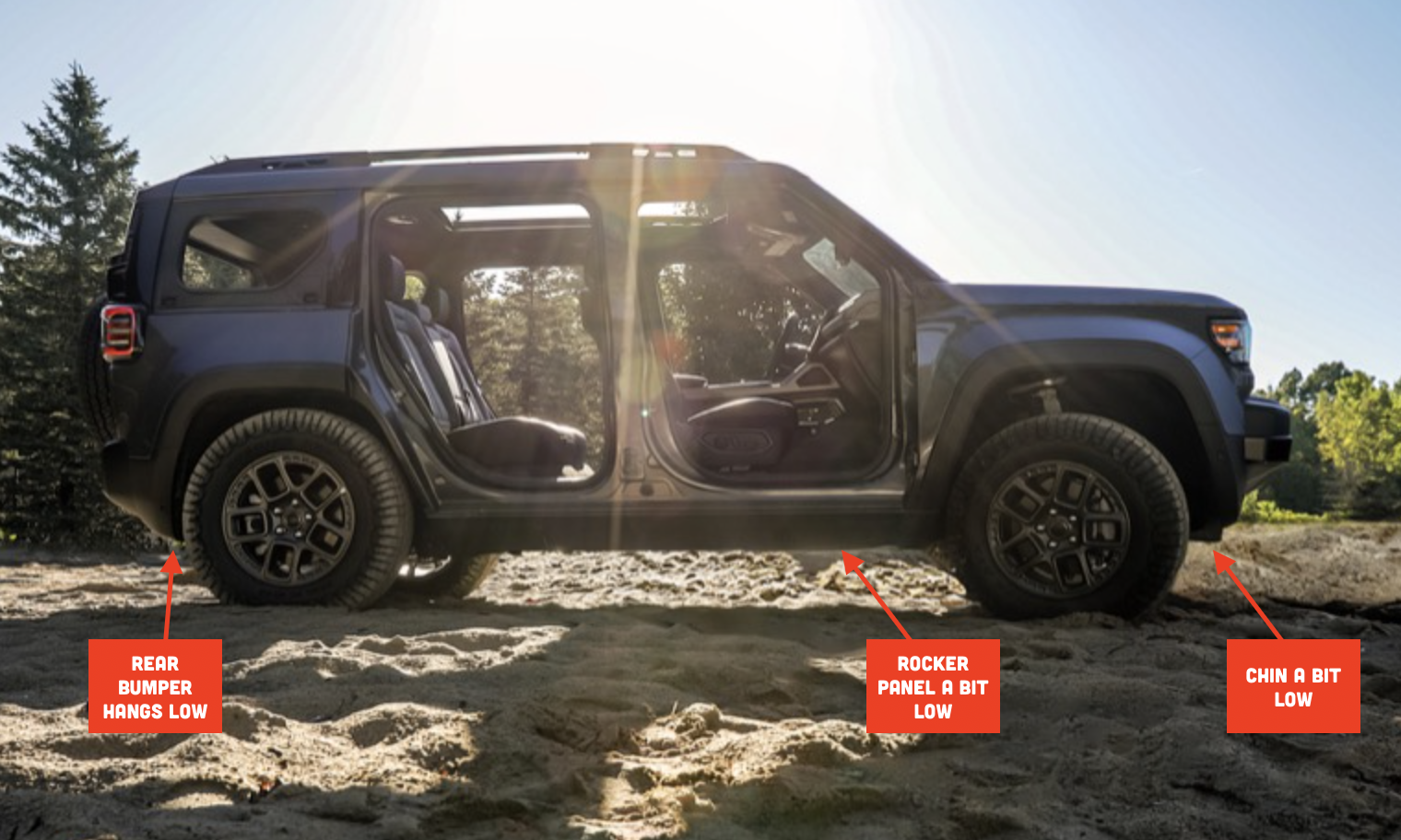

The Recon’s ground clearance doesn’t appear as well optimized as my YJ’s (or the current Bronco’s or Wranglers), with rocker panels, a front chin, and a rear overhang that look very much like rock-bait. The clearance is still decent compared to many modern 4x4s (which have to meet stricter aerodynamic targets than my YJ ever did), but without air suspension, there’s absolutely zero chance that this vehicle could get through the Rubicon trail without a ton of scraped black plastic.

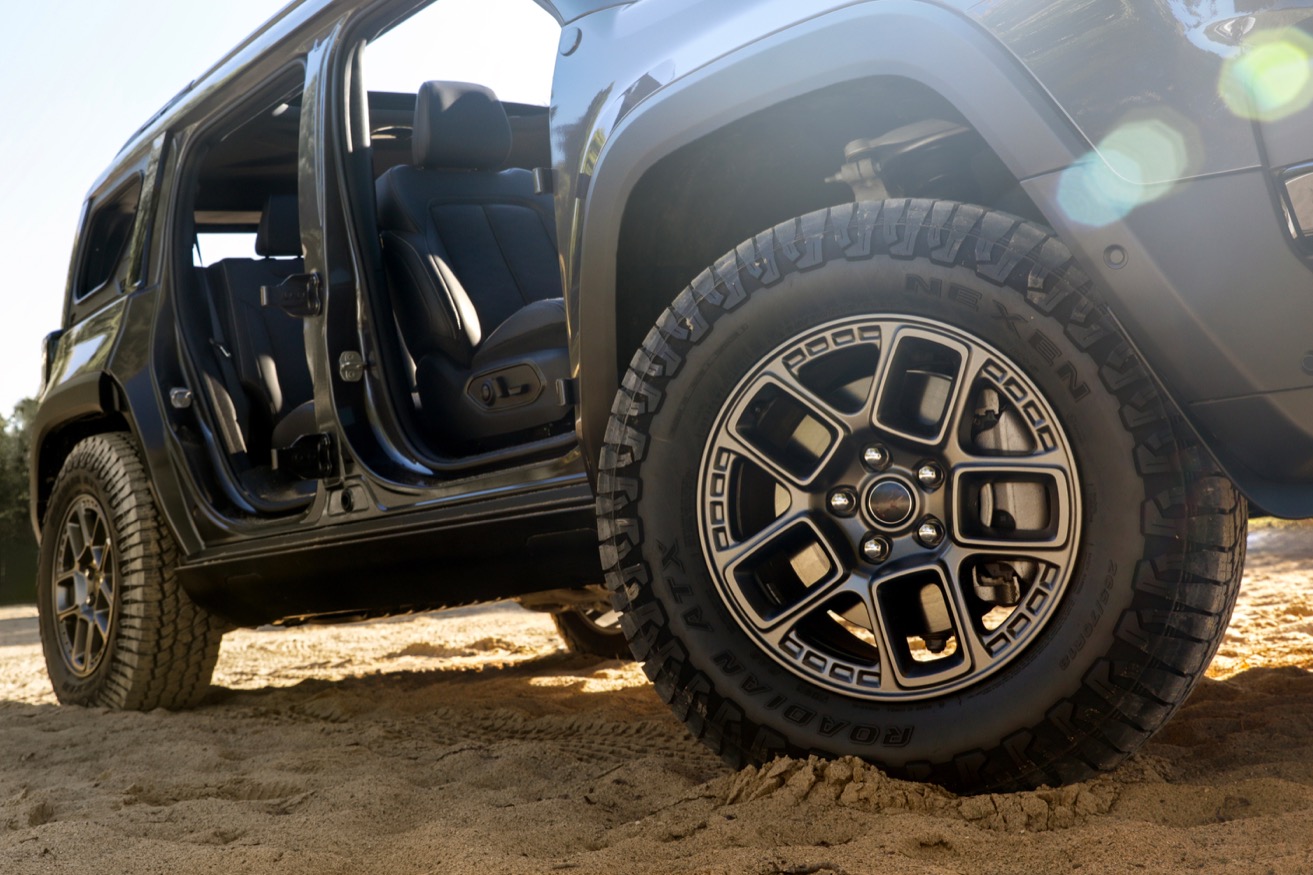

The Jeep Recon comes with 33-inch (265 70R18 — so just under 33″) Nexen Roadian ATX all-terrain tires, which are generally regarded as great overall on-road/off-road tires — not too loud or knobby like mud-terrain, but not going to leave you stuck in a moist front yard like a low-rolling resistance street tire.

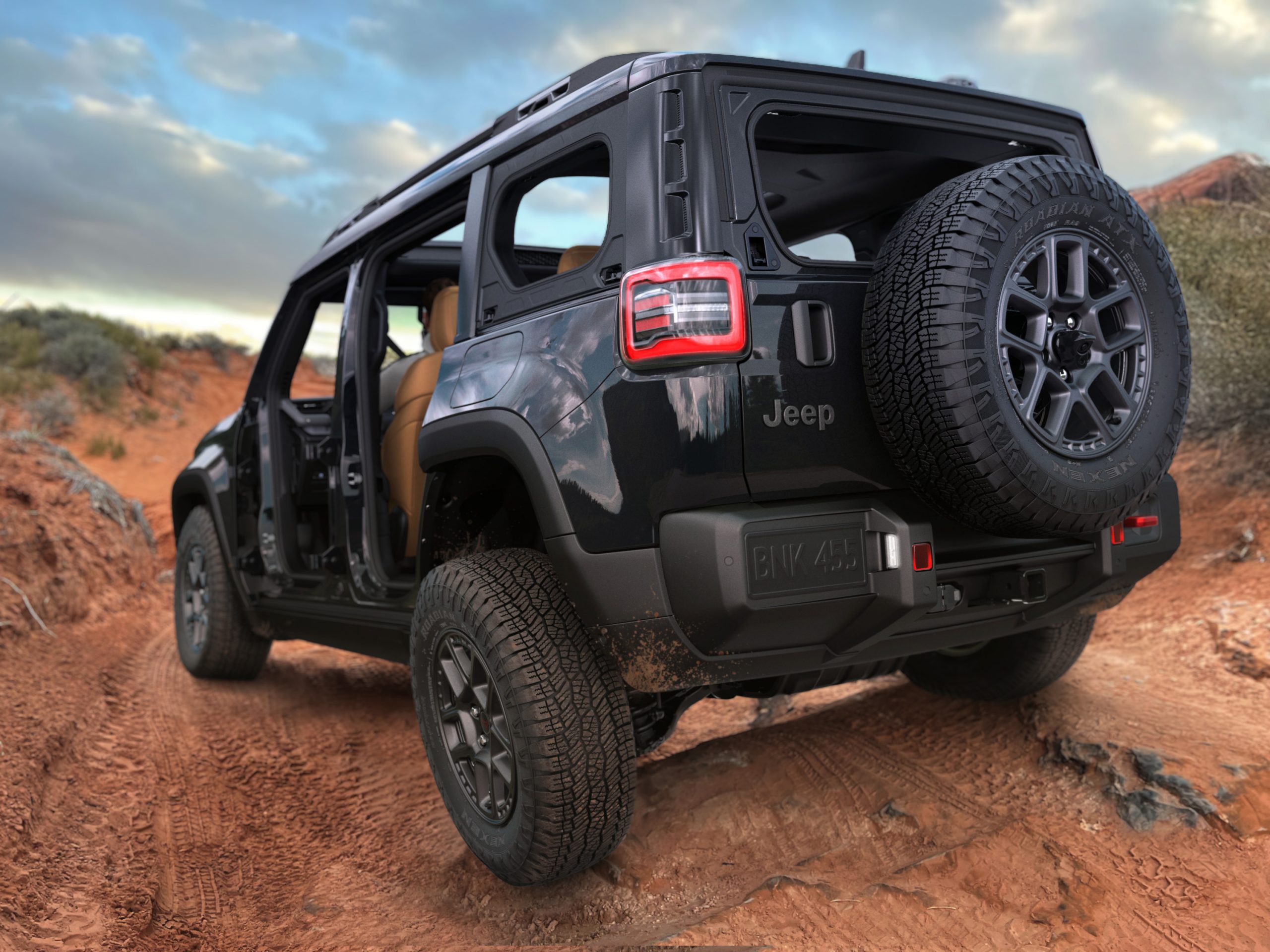

Image: Jeep
The image above shows what looks like fairly decent flex for an independent suspension setup. But it’s no comparison to a solid axle like this:

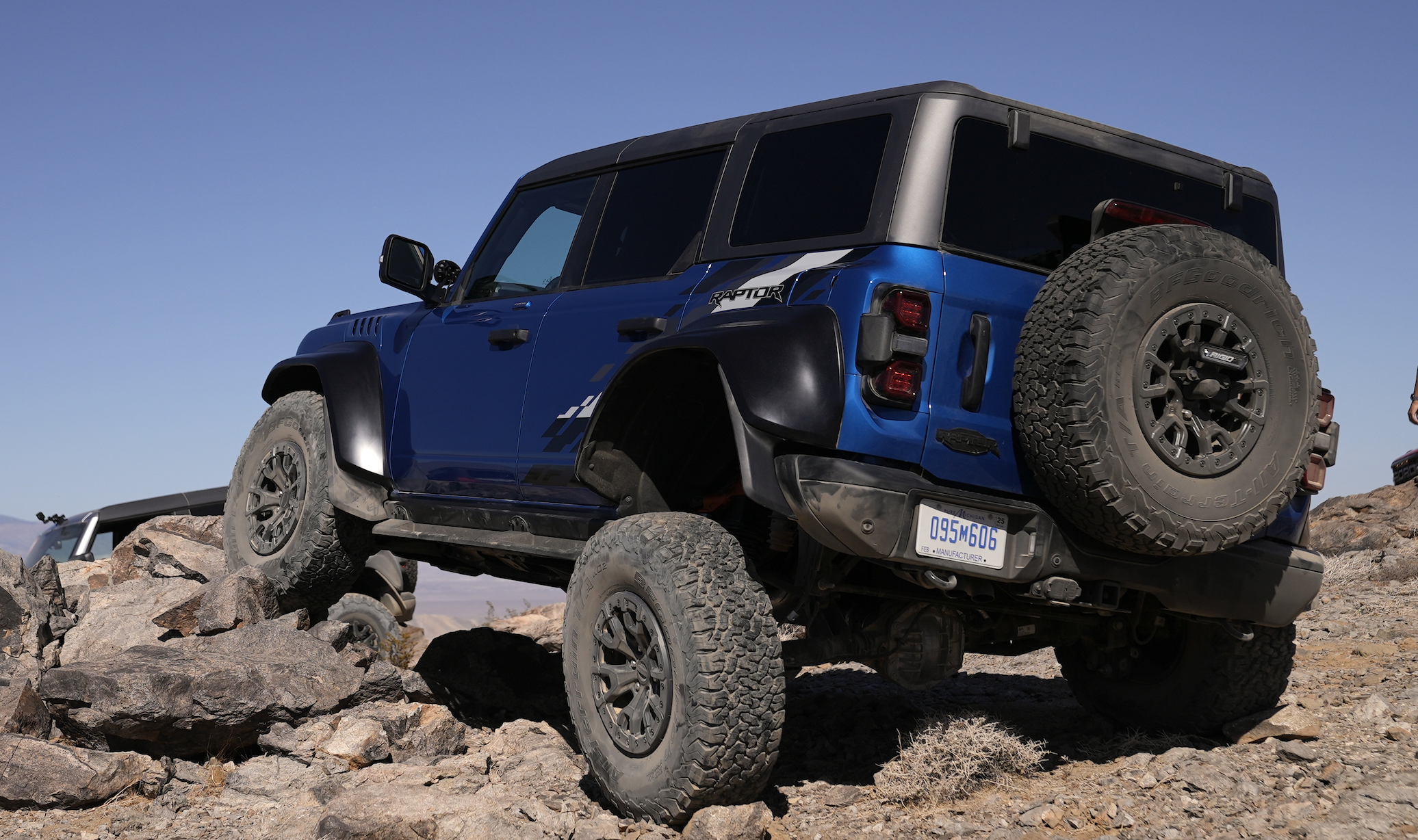

Image: David Tracy

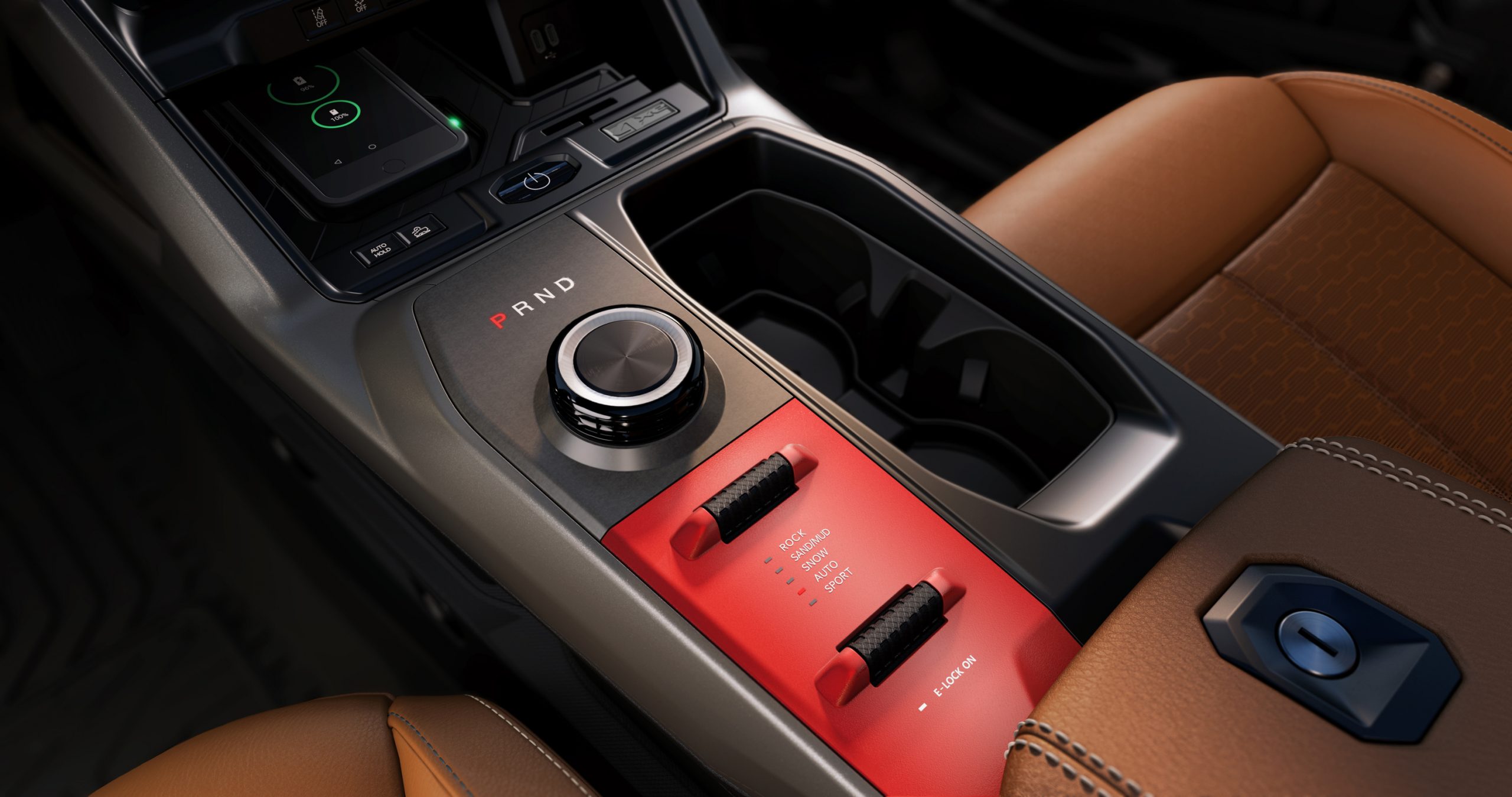

Still, when articulation is limited, the (rather effective) bandaid to the problem is a traction-aide, and the new Jeep Recon has the ultimate: a locking differential.
No, it’s not two locking diffs like some of the most hard-core off-roaders out there, but a rear locker goes a long way, and the Recon’s is a legitimate electronic locking differential integrated into the Stellantis-developed rear Electric Drive Module. It’s there to keep both rear wheels spinning at the same rate by mechanically connecting their angular velocities; this means that, if one rear wheel lifts off the ground, the other can keep the vehicle moving forward, whereas with an open differential, lifting one wheel off the ground will render the other wheel on that same axle useless (at least in terms of propulsion).

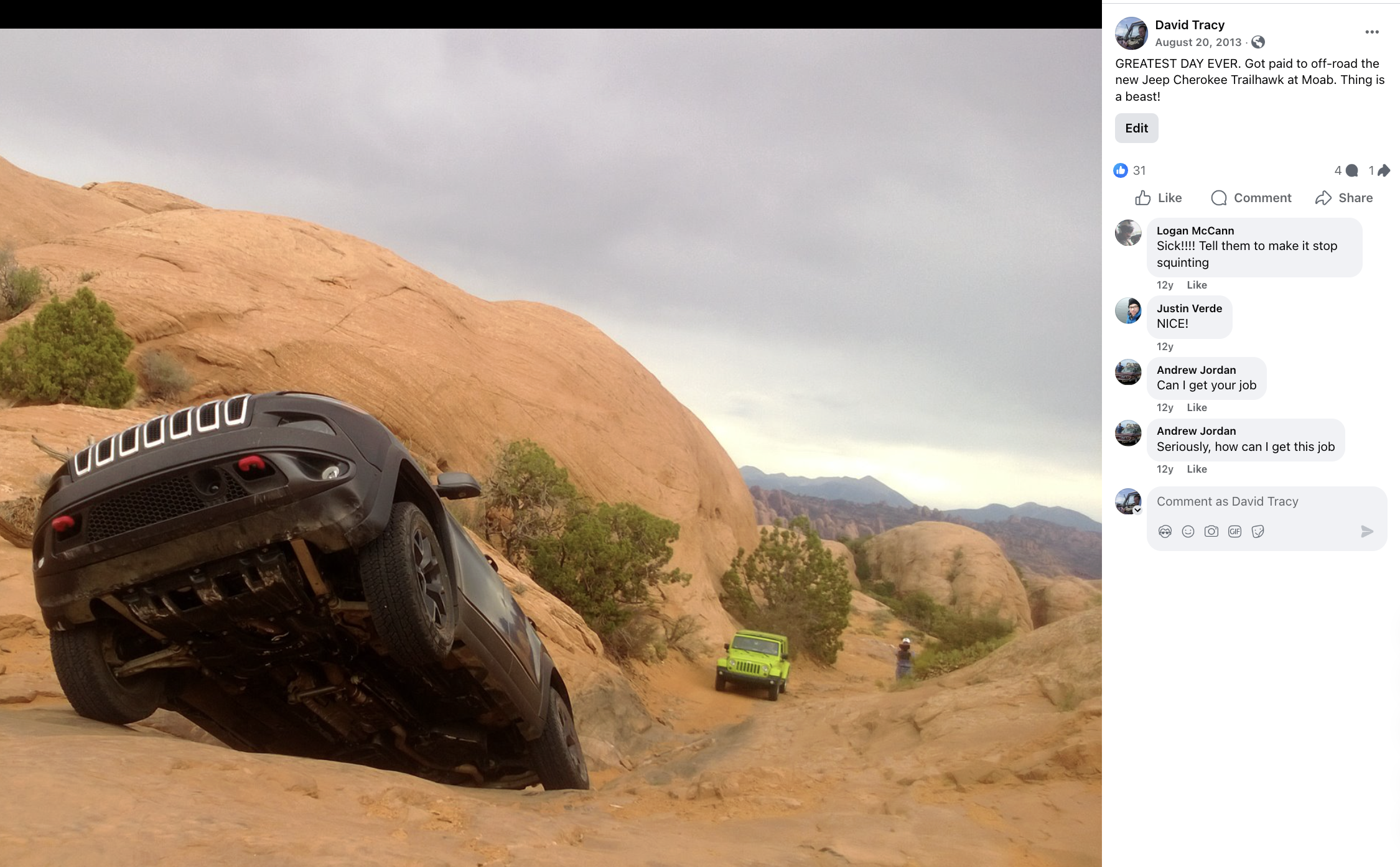

The very first vehicle I ever off-road tested back when I was a Jeep engineer was the Jeep Cherokee KL. As a diehard Jeep XJ guy, I thought the KL would be hot garbage. It looked hideous, the fully independent suspension couldn’t flex, and though the geometry looked good on paper, in reality the rockers and fascias were too low to the ground.
But when I went out west on a “hot trip” to see how the KL could do on the rocks of Moab, I was legitimately impressed. Thanks to that rear locker, that decent geometry, and the underbody skid plates, the thing was an absolute billygoat on even the steepest grades.
Sure, by the time we were done testing, the plastic on the rockers and front/rear fascias had loads of gouges in them, just as I’m sure the Recon will if I get a chance to off-road it, but the KL got the job done, and to this day I respect it. It’s not nearly the off-road platform that the XJ was, but especially compared to the other modern crossovers out there, the thing took care of business.
