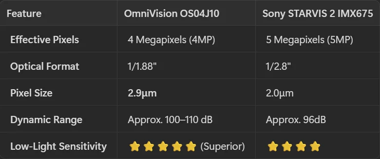

We often talk about dash cam resolution, but the sensor inside is the real hero, especially when driving at night. This article breaks down the differences between two major players: the Sony STARVIS 2 IMX675 and the OmniVision OS04J10. The findings challenge the common belief that more megapixels automatically means a better image.
Here is a quick summary of the core specifications:
The Critical Factor: Pixel Size
While the IMX675 boasts a higher 5MP resolution, the analysis points to the OmniVision OS04J10's significantly larger pixel size (2.9μm vs. 2.0μm) as the key differentiator for dash cam performance.
Think of each pixel as a container collecting light (photons). In low-light conditions, the size of the container (pixel size) is more important than the total number of containers (total pixels). The larger 2.9μm pixels on the OS04J10 can capture more photons per unit of time, leading to three major advantages:
1.Brighter Images: For the same exposure time, the OS04J10 achieves a higher signal strength.
2.Reduced Motion Blur: To achieve the same brightness, the OS04J10 can use a shorter exposure time, which helps freeze motion and reduce blur from moving vehicles or your own speed.
3.Superior Signal-to-Noise Ratio (SNR): More signal and less noise means a cleaner image, especially in shadow areas. This is crucial for identifying details in dark corners of a parking garage or restoring license plate information in backlit scenarios (like a car with bright headlights).
The article suggests that the OS04J10's design prioritizes light sensitivity and dynamic range (up to 110 dB) over raw pixel count, making it a potentially superior choice for the challenging, high-contrast, and low-light environments typical of dash cam use.
What are your thoughts?
Have any of you used dash cams with these specific sensors? Does this technical breakdown align with your real-world experience?
For the full, in-depth comparison, including visual examples and a more detailed explanation of the physics, check out the original blog post here:
Click here to read the full article: Sony Starvis 2 IMX675 vs OmniVision OS04J10 for Dash Cams
Let's discuss!
